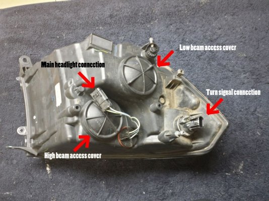

In my 2011 i got the same headlights, the come with a halogen low beam bulb in them already and the h11 wont fit. For the high beam I have a 9005 bulb in that and havent had any problems with the seals. I figure it's gunna be the same or similar.

JohnD72........no extra harnesses are needed.
Here's the beef:
Truck has a single connector - H13 to feed lights. Doesn't matter what set you have, duals or quads...........BOTH have a single H13 connection. The duals, that connector plugs to the H13 bulb. The quads, it plugs into a harness, which then splits inside the light to the H11 / 9005 bulbs.
Trust me. I know a few things on these. LOL I've ran duals and quads on my trucks, seen just about EVERY aftermarket light for these trucks..........they ALL have the same connector. H13. plug that butthead in. Done.

one plug (back of the quads there).
