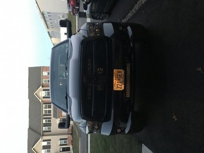

Just took mine in for this service today. $98 service manager was extremely knowledgeable and friendly. However, the lec is not working. Turn signals work but puddlel ights do not. Will have to go back on monday.

So glad to hear that so many dealerships are open to doing this, we just had a new one open up about an hour away, maybe I will try them! Thanks!
Cali,
I am having issues with my puddle lights. Dealer checked and lec is in my truck.
Should i reset truck by draining battery to see if a reset works.
Any suggestions would be great. The turn signals work fine and mirror directions are fine.
I am using eccp mirrors.
