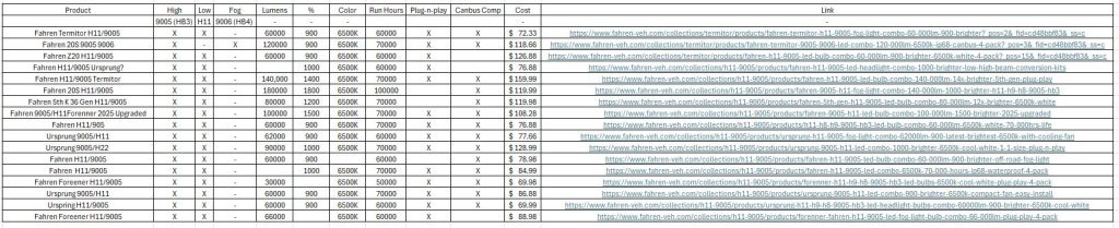

Okay, I am an engineer and got way into this... Here is a list comparing all the high/low bulb replacements for a gen4 without projector lights. This is solely based what I could find on each product page, noting that the title information (mainly lumens) didn't always align with the description. Can anyone chime in with what bulbs they got and how they like them?
I plugged this into Microsoft Copilot and it said for quad reflector style housing, lumens isn't the deciding category. It said to high lumens will scatter light, blind drivers, and be an issue in snow (big deal for me in ND). It said 60K Lumens is ideal and no more than 100K, can anyone confirm that is true?

Those lumen values sound out to lunch.
IIRC, I have 9 or 10k lumen bulbs in low beams with my Projector housings and about 14k lumens in the high beams.
They're insanely bright and I suspect if you go larger than about 9k or 10k lumens in the low beams with Quads, the oncoming traffic will be blinded.
I would say the ideal solution would be to buy OE Projector housings from a junk yard and use those.
The Projector housings have a lens in front of the low beams that I believe reduces the light scatter effect, which otherwise could contribute to blinding the oncoming traffic.
Also, check your state laws. Many do not allow LED upgrades to OEM lighting.

I don't know about that but I have a 2017 with Quads. In 2018 I put 10,000LM Novsight leds in the low beams and they still work great. No blinding other drivers. Just a solid light pattern and definitive cut-off line.
Fahrens have a good rep' on this forum.
