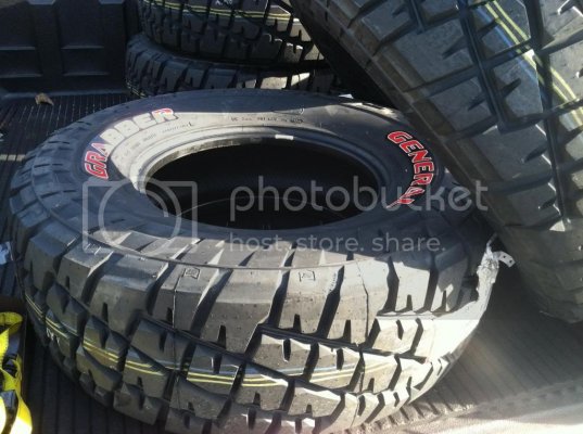

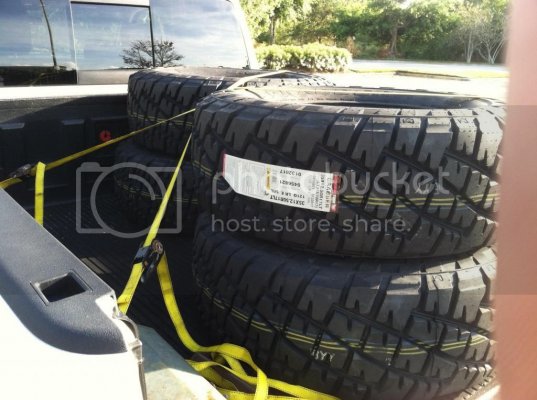

Well, the tires came in today, and I gotta say I think they look awesome! Now the wheels need to hurry and get here.
I think I definitely want to step it up to the 4:10s, I don't ever plan on running anything bigger than the 35's so that should do fine.
