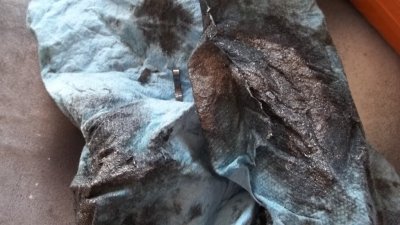

Until this week, the corporate 9.25 rear diff and D-44 front had 3:55 gears. But when I did a long overdue fluid change this fall, the rear diff was full of particles and pieces.
100_0363.JPG .
True to form, the factory trac loc LSD was about to self destruct. The metallic pieces are bits of clutch plate material and the metal fragments are retaining clips. The fluid looked like metallic paint.
While cleaning out the case and replacing the diff oil may have slowed the process, the outcome was inevitable.
Sooner or later the metallic particles would wear out the bearings. The nearly too small pinion bearing would be the first to yield to the punishment. There would be the warning death howl, and then the instant and motion stopping carnage.

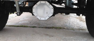

Motive gears provided the rear set, and Dana supplied the front gears. Bearings were hand picked US made, in addition a transfer case saver was installed. I'd already had a 4:10 and lower front carrier which was worn but serviceable.
Dallas and Justin did a great job on the install and ran the 3 critical initial heat cycles to assure a proper break in.
Lastly, no more chrome! I'm a powder coat man. Chrome covers will be for sale soon.
