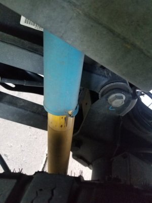

Here's a pic of the left rear shock...
Looks like it heated up and melted from friction or something...
Wondering if it may be a sign of something bigger going on back there...

That definitely doesn't look good, I've got 52k miles on my '17 and other than dirt the shocks look brand new. That said, it could be a tire balance issue that has caused it.
It is also entirely possible that it's the road you're driving on. When I lived downstate, there was a section of expressway where I couldn't run in the right hand lane for about 10 miles because it was so bumpy, despite being a relatively brand-new road, in any of my trucks, regardless of 3/4 or 1-ton, dually or not. My wife's SUVs, on the other hand, didn't have as much of a problem. The issue was every heavy vehicle ran in that lane, and it was really taking its toll early.
I have been through there a few times since moving, and while the PW is better, it's still a bumpy section of road.

Looks like it is rubbing on the shock body. Those plastic shields just slide over the shock and snap on at the top. It may no longer be snapped on and may be why it is rubbing.
Does your truck ride rough on asphalt and concrete or just concrete?
I'll check the to see if the shield is loose for some reason.
Truck rides rough on both asphalt and concrete. Some areas are obviously worse than others though.
