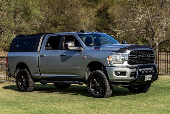

So I ordered and installed in my driveway, the Thuren 2.75" Leveling Kit with Thuren/Fox 2.0 Shocks at all corners, Thuren Front Springs, Thuren Track Bar and King Racing Shocks Steering Damper. Super impressed is all I can say. The truck rides more like a 1/2 ton now. Huge huge difference in ride quality. You can feel the suspension working in a good way. The truck is a joy to drive in town and on highway. I highly recommend checking out https://www.thurenfabrication.com/ Nope, I'm not paid or sponsored or anything, just a customer who bought after my own extensive research online etc. These guys and gals specialize in Dodge/Ram 3/4 & 1 ton. Anyway, just my 2 cents. DSC00923_1 copy.jpg

Nice!
Stock rear springs? 35” at4w’s?

why does every level truck i see look higher in the front ?

The factory front spring rates, coupled with the mushy shocks, are nothing but a catapult for your head to smash the roof over every speed bump you encounter. That kit fixes it...all of it. Hardest part is torquing the lock nut on the adjustable track bar. Truck looks good...enjoy it.

how you plan to haul anything or its just the family grocery getter ?
With these trucks, imo, if the back is about 3/4”-1” higher, then it looks good and level. But, if you actual level it to where the fenders are the same height (“level”), then it looks like its dragging ass.
