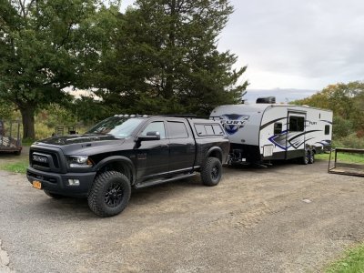

34 1/2’ Toyhauler! A bit over 11,000lbs with RZR and water etc! With bags and Equalizer WD, it tows fine! Except for the horrible gas mileage, I enjoy wheeling with it, towing with it, and just plain driving it!

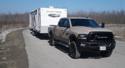

18 Power Wagon
I agree with the comments above....and It is a tough decision ! My 06 mega 5.9 TD is bullet proof and it still pulls like a freight train. PW also pulls no problem.I love my new 'to me' Power wagon. There is definitely more maintenance costs with a newer 6.7 ctd compared to my 5.9 though IMHO. Sorry ...I'm not being much help. My Diesel gets better MPG than the PW but not sure about newer 6.7. I am towing about 8200lbs. oldnew2.jpg rvandtruck2.jpg powerwagonrv.jpg
