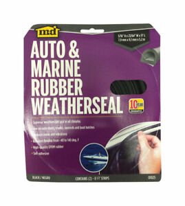

Not sure on the cab vents, but look into the 3rd brake light seal as well as the cause for your water intrusion. Very common issue, would recommend replacing the seal with something like this

Yea any time it rains real hard like torrential downpour I get water under my rear seats I took rear seats out silicone around the inside of the vents also re sealed the top brake light it fixed it for now.
I already bought the weathertstrip to fix the third brake light although I dont think its leaking. I have no water on the headliner, but i'm going to reseal it anyways.
