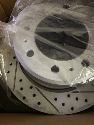

Thanks for all the replies guys.
I just installed powerstop drilled/slotted front rotors and their pads and I’m unhapoy with the braking performance.
I’ve bled and re-bled the brakes and I’m not thrilled with my stopping power. OEM stock was better.

Which version of their pads did you get? Did you do the break-in process after installing them?
I know the voices in my head aren’t real, but man, do they ever come up with some great ideas
I did their prescribed break in procedure. I was sure to do that.
Can’t recall the pads I went with. Hafta check the box at home.

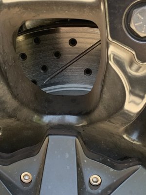

I did power stop brakes and rotors. Drilled and slotted.
Did break in procedures, brakes still felt less than OEM.
Changed fluid in master cylinder with a 50cc syringe, taking all fluid out and then replaced fluid. Then I bled each wheel until I got fresh fluid out.
Had them on about 5 k.
in addition to the above, ive
adjusted the parking brakes per the manual and started using the parking brake every time I turn the ignition off when parking.
My brakes now stop as good or better than when new.
