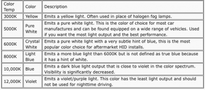

I had 6000k hids on my Chevy and they looked good but they had blue look to them
I want the purest white and I did remember which that is
As for the open diff in the front what does that mean
Meaning which ever wheel has the least traction will spin. It's like a front wheel drive car or an open diff on the rear. One wheel wonders! :boxed:
5000K is pretty common. It's what I bought from Jeremy to put in my G8. It's a pretty "stock" look.

Explanation...
