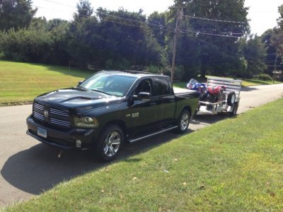

A couple of months back I got a 2013 1500 sport and would like to put either bilsteins or a hbs leveling kit on the front of the truck. I do make deliveries with the truck and carry 1200lb or more in the bed quite often. The truck is also used to carry my gear and tow my racebike in a trailer. Over the winter I'd also like to put a set of Toyo extremes in 305 55 20 on the stock rims. Which of these options would be best and would avoid being nose high when carrying a load.
Here is a pic of the truck loaded up.

It looks like you are pretty squatted with the load you are carrying. Your rear shocks will not last long if you ride like that often. Airlift1000 air bags will help significantly. They do not add any extra payload capacity but they should give you enough extra support to keep up with the height of the front level you want to install.

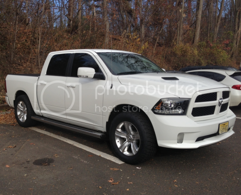

Just tried to fit the Nitto 305 55 r20's on the stock rims at town fair tireand they don't fit unfortunately. They hit the control arms.
Which Nitto's did you try to fit?
I have Nitto Terra's 305/55 R20's on my 2014 4x4 oem sport rims and they do not rub or touch any of the panels or suspension/steering components.
