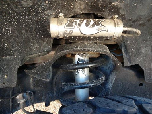

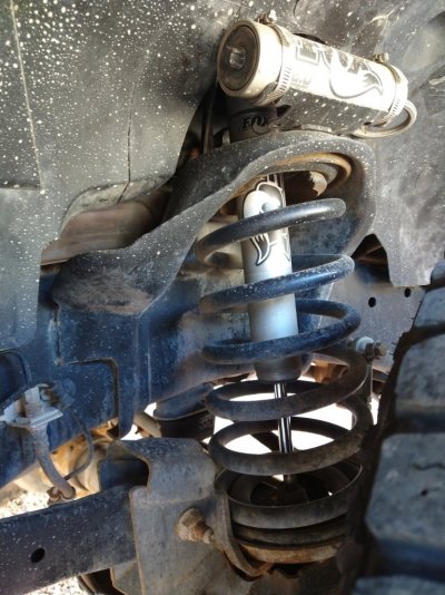

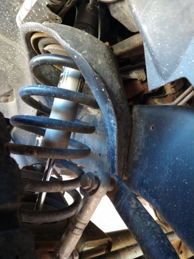

Whats up everyone? new here. I just bought a 2013 Ram Tradesman Power Wagon. Truck does not sit level. I believe this is aftermarket coils? Could the truck be sitting low in the front due to the age of coils? Can I use pucks to level the truck? I have searched the interweb and cannot find an answer. I want the truck to sit level. From the info I did find I think I am going to have to order new coils. But not positive. Truck is not lifted in the rear, bone stock. Thanks for any info I can get.

Well if the truck dosnt sit level, its possible they are stock coils then. They came with a rake. It does have aftermarket sway bar end links, however, and obviously the shocks.
You can level them with a puck. Cheap way of doing it. Ive had 1.5” coil spacers on top of my pw springs for over 6 years now. Never had an issue.
