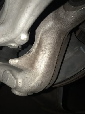

So I joined the Ram Family about a couple of months ago, and I installed a Rough Country leveling kit on it, I know for a fact I need to get an alignment due to the fact that I can see it! I am waiting on my tires to arrive to get it mounted and then get an alignment done, anywho since I pull the leveling kit on the truck, whenever I go over a curb I feel a knock on the left side, additionally, I took some pictures of what I assume is not right, the metal seems to be scraping. Has anyone run into this ? I am hoping I just need an alignment. Any info would be great! I ride a 2016 Ram 1500 Sport 4x4.

I would double check all the hardware to make sure everything is tight. (including the wheel) A loose nut or bolt would definitely give you a knocking sound.
As for the rubbing, from the pics it looks like the steering stops. Completely normal, nothing to worry about.
