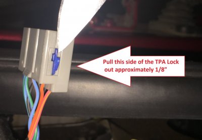

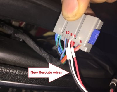

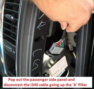

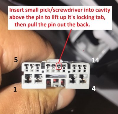

Here's some of the pictures related to the camera reroute. There should be small embossed numbers at some of the cavities on the back of each connector as a reference to make sure you are using the correct pin locations.
You should be installing the pins into the female connector of the harness going up the passenger side A Pillar.

Part 2...

It sounds like you didn't get the pins seated correctly in either connector. So yes you absolutely need to remove the red lock plate on the radio connector to get the pins installed and you also must get the passenger air vent connectors blue pin lock in the release position to install the pins. Hopefully none of the pins were damaged.
