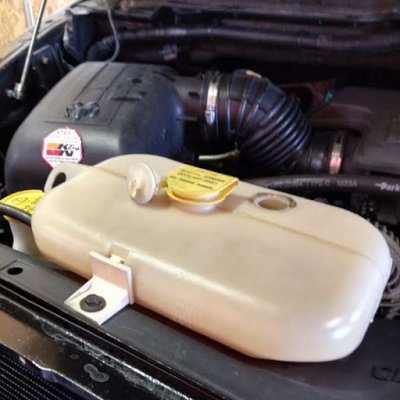

I have a 2003 Ram and I am looking at the over flow tank and it does not look like the one that should. Can some help me?

That overflow in the picture is the same overflow tank I have on my 2004 Ram 1500 5.7 HEMI truck. The hole in the top of the bottle is supposed to have a grommet installed so the nipple can snap in to the grommet and then you attach to hose from the radiator to the top nipple.

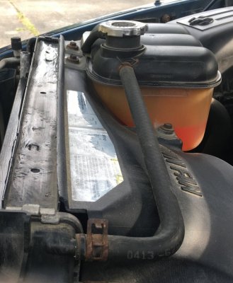

Thanks but I have the hose coming from the radiator going in to the side of the over flow tank and that top part all so but nose hose.

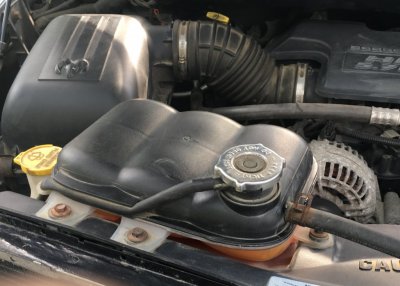

Must not be a big deal as I bought my 2004 5.7 without the top hose, just the nipple sitting up there.

On 03's the overflow tank has a pressure cap. 04+ they moved the pressure cap to the rad where it should be. Question is do you have the correct matching rad or did someone just replace the tank with the wrong one?
