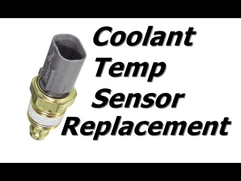

When does it first start, as in when does it turn on at what temp?
If coolant level is good, I'd replace the temp sensor for fun.
Almost always happen when ac is on?

This first..

Couldn't tell you the exact temperature, but usually after driving for a while, so Im assuming engine is warm enough, but the engine temp gauge is not going over mid range. Coolant level is good, so I guess I can change the temp sensor, although I dont have a check engine light either. So who knows...

That's just a cheap option that has a decent chance at fixing it, or I wouldn't say it. Like a ten dollar part, sometimes cheaper, keep the old one. It just would suck if it you changed something else and it was this tiny thing. Clutch is a costly item, so in my thinking I like to go simple and cheap and work my way up :)
Even that video he had a CEL but no code, so who knows.
