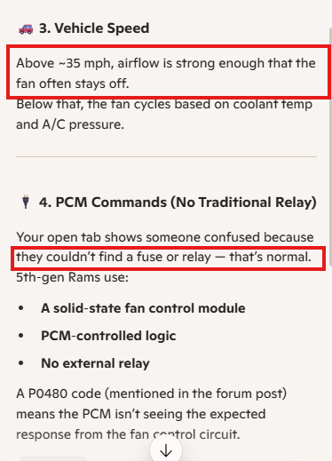

No fuse can be seen, no relay can be found...
The PWM controlled fans used in the Gen5 truck don't have relays, there is a control wire that sends a signal that controls the fan from off to full speed. You need a meter that's capable of reading duty cycle to check the speed signal.
The fuse size for these fans are sizes le considering the motors are upwards of 850 watts.

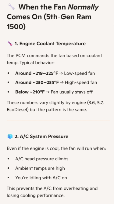

Yesterday I had to go over the pass to pick up some groceries. I watched closely the coolant temps. I was surprised how much it changes and how quickly. Saw as high as 235 before the fan and system sought to keep the engine from overheating. I did find that on steep grades it is best to take over control of the transmission and down shift to 5th or even 4th at 65mph as the engine temps go lower and stay lower.
