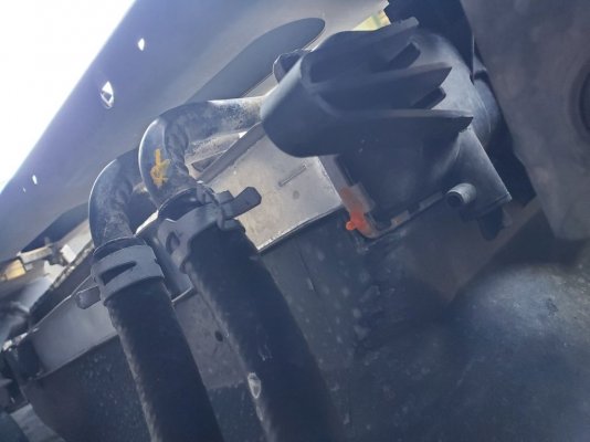

I'm looking for a radiator recommendation. I just had my 4th radiator in as many years spring a leak, to say I'm frustrated is an understatement. Usually, it's the tank that springs a leak, this time it is the core leaking. I can't recall what two of the brands were, but the first was the OE radiator and this one was manufactured by OSC.
This is my daily driver, so I am not looking for high performance, but I do live in southern Arizona, so being able to handle the heat is a plus. Even a full aluminum radiator is acceptable as I won't have to worry as much about the tanks leaking.

It looks like the top tube, close to or maybe even right at the cap(?) weld seam. I use nothing but HOAT and distilled in my systems. The only additive I added is a UV dye to locate the leak, and that was before I found this obvious pinhole leak.
