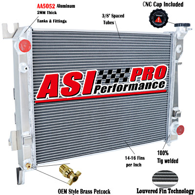

On my 2004 I ended up putting a screwdriver thru the radiator. Bought a new one at O'Reillys, think it was about $180 or so. That was about5 or 6 years ago. My 2011 is starting to leak at the tank seam. Bought a 4 core aluminum for about $250 w/ shipping. Just need to put it in.
This is the one I got. It sure is pretty.
Here's one for your 2003 (only a 3 row though)
