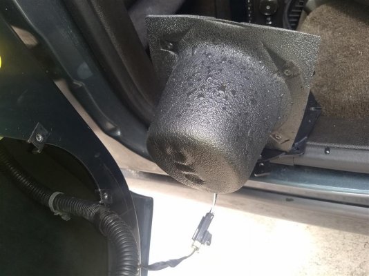

I read this
Before you do a lot of disassembly, you can test the speaker in car, by unplugging it and take a 9 volt battery and momentarily touch the 2 speaker wires. If your speaker is okay you'll see the cone move and hear a little buzz. if you don't get that, then your speaker coil is open or the cone is jammed up.
2006 Impala uses the same radio
moisture in the speakers possibly
Quote:
well how do i keep it from happening again?
Replace them with anything but the stock POS base speakers. Sure, moisture contributes to their demise, but they are self-destruct mechanisms. The coil leads rub and short and arc when played even a little loud, and quickly burn through the leads to an open, and I’m sure it would happen even if bone dry. Even the crappiest automotive speaker should tolerate a little moisture.
But also follow the advice give elsewhere to minimize the moisture problem.
https://www. chevyhhr.net/ forums/problems-service-repairs-42/radio-only-works-thru-tweeters-60502/page2/

I read this
Quote:
through Crutchfield
