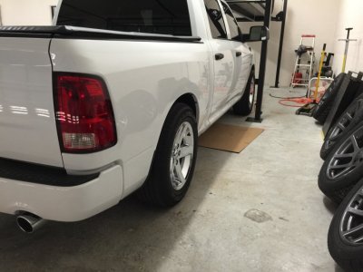

Whats shaken guys, ive been reading and searching the forums/threads here but haven't posted yet. Looks like a bunch of cool guys with similar interests as my own.
First off I love my Ram, been wanting one since my buddys 2011 he had. Always loved the lowered look especially on the newest gen 4's.
Needless to say I started with the cutting the rear coils to level her and that's all it took for me to be hooked. I ordered the 44052 kit (which i hope is correct) and started mid day today and recently finished after my wife watched the kids.
Just some notes on the parts, parts are nice quality nothing was missing. Install would have been a walk in the park except for the rear bump stop removal. That part really sucked and i've read other posters mentioning the same,,, they are right. Its not easy to get to the welds with a 4 1/4 grinder but its past me now :superhack: Think i was so pissed i didn't even install the aftermarket bump stops.
The pan hard bar bracket was a piece of cake only had to drill one hole in the stock bracket and bolt it all down. The front coils were a little tricky since you have to push down on the lower control arm pretty hard to get the new spring in there.
Finished just when the sun went down, double checked all the bolts and dropper her down for the first ride. Ride is very similar and you can now feel you are lower to the ground. Shocks seem ok too which is a plus.

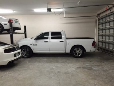

So there is issues and or questions. After test driving her for a hour or so I remeasured the front and rear fender hieghts. I do not understand why but the front is 1/2 higher then the rear. Front measures 35 1/2 and the rear measures 35. Is this normal or did i do something incorrect or did i use the wrong kit?
Other issue or question is the front bump stop, wow is it close to the a arm, i so want to cut it off but not sure if these is a good idea or not.
Sorry for the crappy pic's, will get some better angles with the new 22" rims as soon as she's aligned and I make sure i figure out the height difference.
Brad

Few things, that looks awesome and low! Second, love your garage and lift!

A lot of kits I have knowtice the fronts seem to sit high witch I personally don't like. I have never lowered a truck just cars my guess is with the weight of the engine it will settle some. Love the truck these 4th gens look good dropped, if my truck was 2wd it would already be dropped just can't bring myself to lower a 4wd. And love the garage that's what I need.

Thanks for the props guys. Looks like i'm going to have to see if the front goes down, amazing how the little things get to you. Also going to cut the front bump stop. Funny but it doesn't say this in the instructions just the rears.

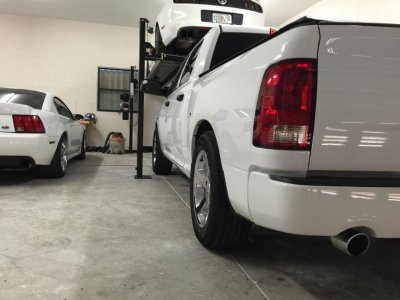

Thanks guys, i'm not sure what to do since i agree since i doubt its going to lower 1/2 in the front especially by now with all the driving ive done. easiest would be to cut the front springs but I don't want to go any lower. Suck i'm going to have to put cut the back springs to get the height i want which is stupid since it really should be right out of the box imo. I want a little rack to her just not a backwards rack
lilzilla2008, love my 03 cobra this is my 3rd one, surprised you didn't see the 13 Shelby in the pic stripe delete so it kind of unusually to see them that way.

I noticed it I'm just partial to the new edges. Even though the newer body styles do look damn nice, still waiting to see a '15 in person though

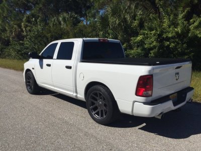

Just took some more pic's and did some more measuring, don't think its going to settle any more then it is. Not only knowing its 1/2+ lower in the rear it just looks funny , looks lower in the rear possible could be the body lines i'm not sure. It needs to be at least another 1" in the rear to make it look balanced correctly at least that's my imo. I'm wondering if these kits are universal to all cab lengths, a standard cab should be fine with this kit but with the crew cabs would have more weight in the rear which is why I'm sagging in the rear or at least thats what I'm thinking.
Now what? Do I cut the fronts or cut the rears stock coils and re-install? If i do the rears then its pointless to have purchased the kit imo, could have saved some bucks and do what some of the other guys here have done and cut their stock coils to get the exact right height they want.

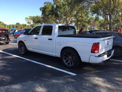

up date with 22" SRT-10 guy metal grey wheels.
