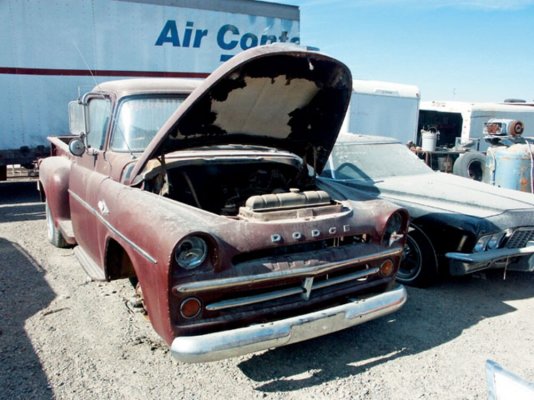

Arizona, the State that all the auto dismantling yards moved to, when california drained them of any chance of making a profit
