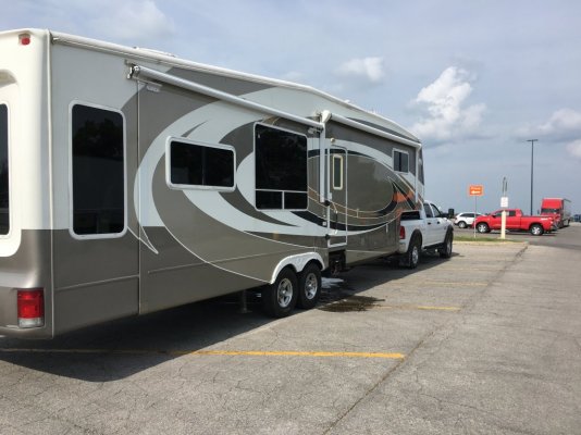

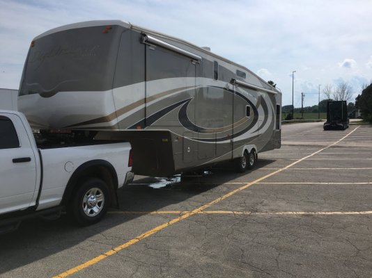

Funny, mine appears to be level....not the best pics.
One of the pluses of alt ride hide with the auto level.

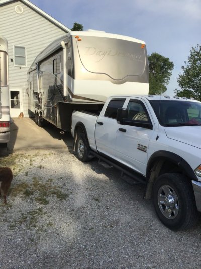

Believe it or not my 17 2500 was “too tall” towing the 5er nose high if I leveled the truck with the bags. I did get it better via hitch adjustment, but not optimum. Only way to be truly level was to air up bags on 5er and run the pin box bag at or slightly under recommended line. Terrible angle with these pics as well, but the 17 2500 sat higher than the new 3500 with auto level. When I ran down the highway, I think I had the bags at 55-60psi. I really liked the 2500, but wanted the bigger badder, but lower, brother.
