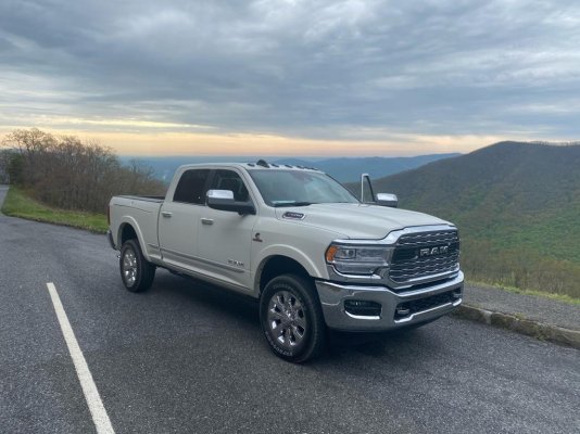

I'm the proud new owner of a 2019 Ram 2500, Limited w/ 6.7 Cummins. The best vehicle I've ever owned.

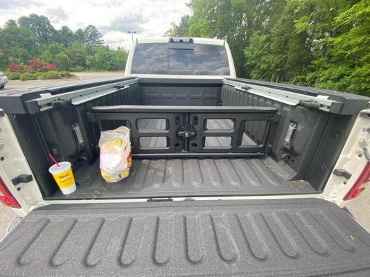

My Truck is Ram Box equipped--love the versatility and convenience of them.
I'd like investigate a 5th Wheel, but I've been told it's not an option with the Ram box. Any experience out there that might help?

I could see the narrowness of the bed being a little constricting, if you got something like a sidewinder hitch it would both help with the short bed and move the pivot point to above the bed rails.

The Sidewinder hitch is a good one but you do have to keep an eye out, and routinely check, the wedge. That's a minor thing compared to how well that hitch works within the truck bed and I think it would work fine with the RamBox option. You'll have to verify measurements and such to be sure.
