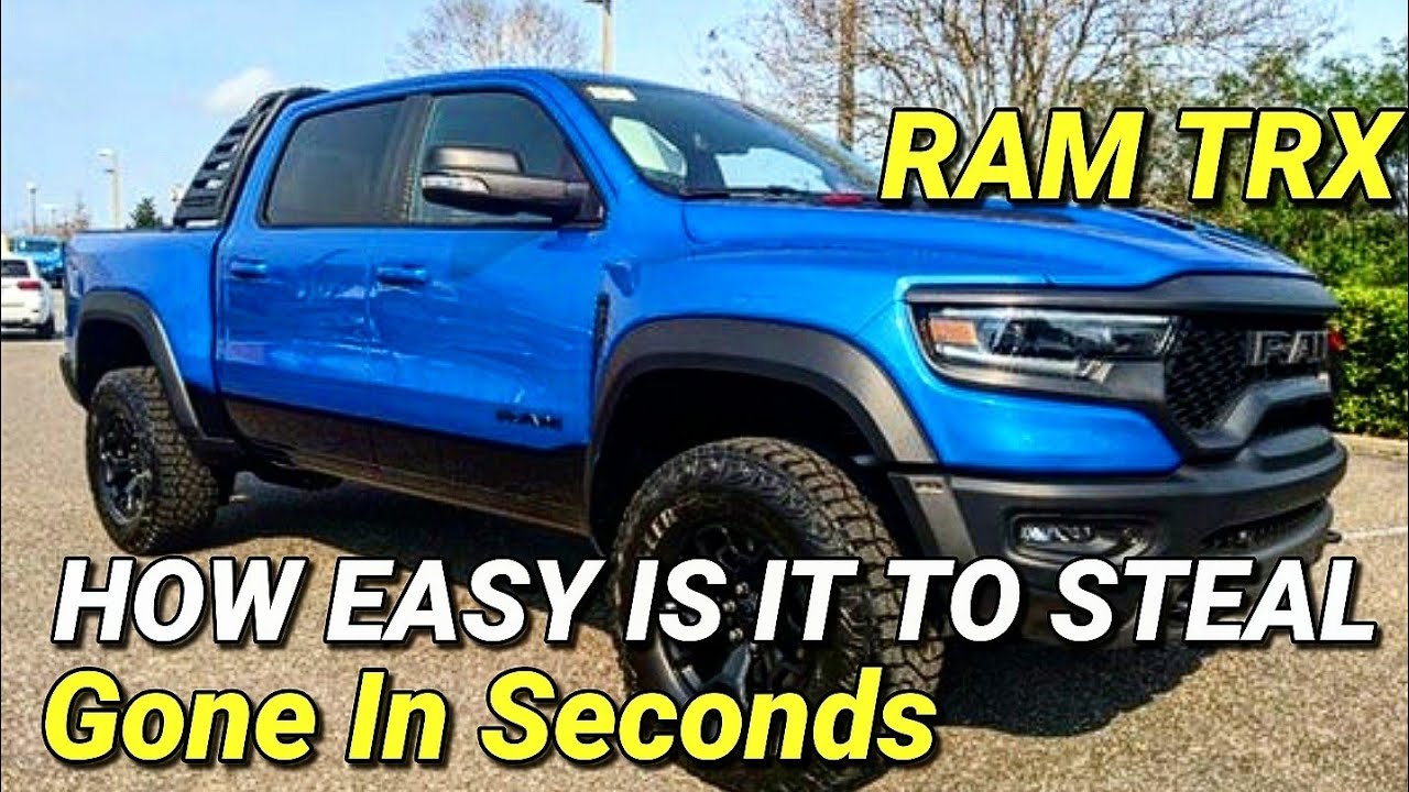

I so wish we could employ the use of these systems in todays world:

This is an easy cheap thing to do
