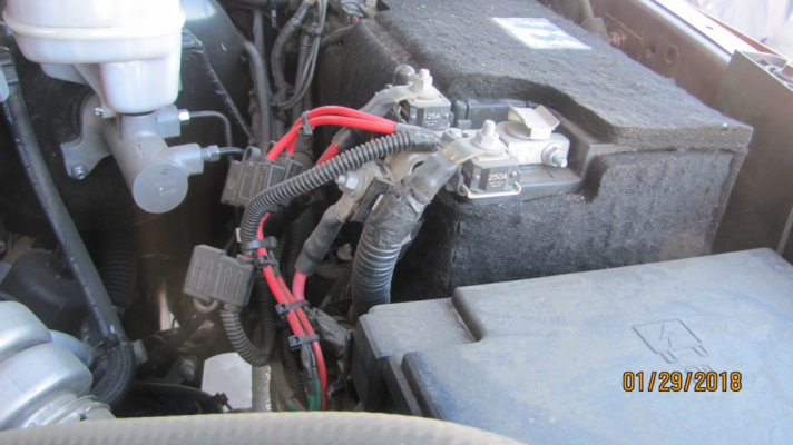

Run a 12 gauge wire from the battery across to the right headlight & back to a place near the hood hinge , then get the mercury switch , wiring & hood light from what ever source
You should use an inline fuse near the battery
