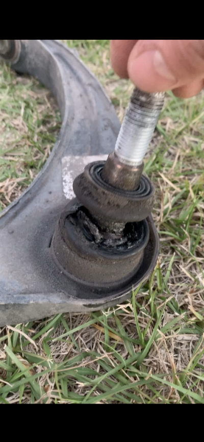

Yup. Found out where all my vibration was coming from. [emoji30]

Just throw a little grease on it. It'll be fine.

Once the boot integrity is gone it's lights out in short order.
