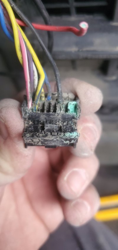

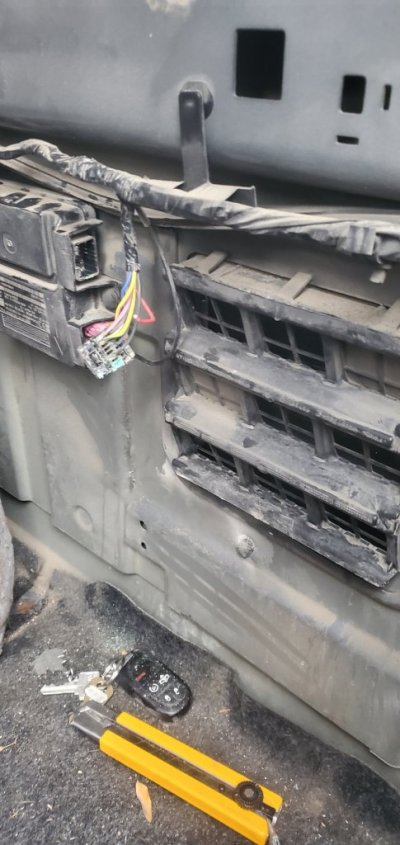

I think I have found the problem. I pulled out the rear seat to get to the RF hub and found it was very damp back their due to the vent that is right beside to hub. And noticed that what I assume is the power wire (to the ignition I think) was badly corroded and when I was trying to remove the connector from the hub the wire (red wire) basically pulled out without any significant force, almost just fell out. Also there is another wire that is white with green stripe that looks pretty bad. So now I'm going to contact the dealer and see if they have a new connector and pins.

That doesn’t look good
2-3 times on my 2014 with Push-button start, the fob will no do anything, I have use the key to open door and the truck will start by pushing the button with the fob
Next time it’s fine
I have never looked behind the seat. Once every 2 yrs I can put up with it
If the socket is poor, you could try some battery cleaner or baking soda and water to clean the contacts
You can buy contact cleaner in a spray can for electrical stuff

spray that area around the RF Hub with
CRC QD Electronic Contact Cleaner
it may help a bunch
Ram now makes improved Cab Vents
it would be the time to replace that one next to the Hub, while the seat is out
The Vents don't cost that much, maybe $10
Good for you finding that, apparently that is not a rare occurrence with those vents. Like mentioned, replacing the vents with new and improved if available. Luckily other than being an inconvenience...it worked out to be a cheap fix for you.
