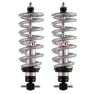

Looking to build up a set of front QA1 lowered coil overs for my 17 Ram Regular Cab Hemi. I am in contact with them now but Need to find out the current front end weight on the ground. Also need to find out how long the current shock is at its max extended and compressed. Any help would be great, I am sure many owners would go this route for a 2", 3" and a 4" front drop.

2800# base weight. 3700# GAWR for a single cab. I don't know about the shocks

Yes. I'm sure they can calculate the spring rate you will need. As far as shock length and travel I looked up the dementions of the Vikings B287 being offered for the ram . They are 9.45 compressed, 14.80 fully extended, with a recommended 11.5- 12.75 ride height. This is good for a 0-3 inch drop. If you are going lower than 3 inches get a shorter shock.

You da man! Thanks for all the info!

No problem. I was actually thinking of doing this myself. Viking has coilovers too. The Crusader #B387 is the same as the B287 but with a threaded body.
If you need to know the actual axle weight on the ground find a CAT scale. For about $12 you can get a print out of the actual axle weight, a lot guys run their trucks/trailers over them to set up WDH. You'll probably want to make sure the tank is full.
