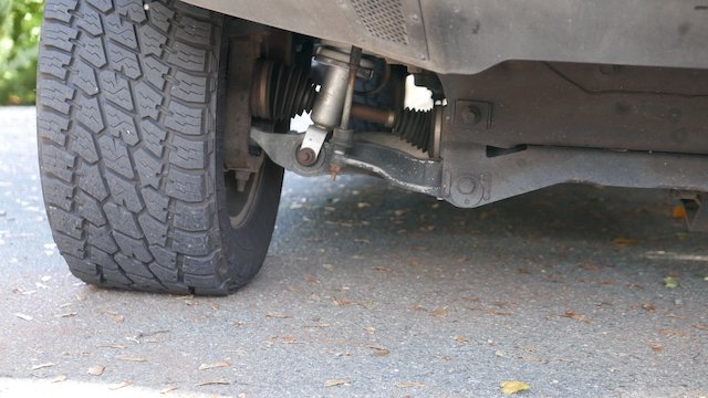

That's a one size fits all strut/coil combo on the heaviest version of the truck and it's probably slamming off the bumpstops every time you hit a crack on the road.
If you posted this photo first it would have saved you a bit of time! :) You'll need ecodiesel coil springs, or aftermarket struts that can be adjusted for the weight of the ecodiesel and the added winch/etc up front.
The good news is now that the problem is apparent so is a solution.

Oh... yeah that's it right there. View attachment 474833

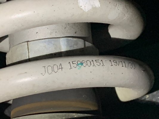

Spoke with Eibach and Pro-Comp today. The techs asked which coil springs on the truck as they agree thats a major issue. See photo. I wasn't able to determine maker despite the branding.
Eibach seems to think their kit, E-80-27-001-03-22 would work. Asked to send photos. The question was the exact lift. Is it 3" or 4". I'll have to head to a dealer and measure a another Ram 1550 ecodiesel to compare.

Pro-Comp (owned by Smittybuilt) tech did say that their ZX2017 struts only work with 6" lift and the Rears (ZX2001 are discontinued and couldnt help further)
It might have been ZX2014 - it's a strut made for stock height because from the strut's perspective you are at stock height. The spacers "don't exist" to the strut unless you're buying struts built specifically for a 4" lift (some of the Rough Country ones, for example are built with an extended length for that purpose) , Then you would put the Eibach ecodiesel-specific coil spring on it, with a stock upper strut mount.
ProComp ZX2028 rears shocks are built for stock height or slightly lifted 1500's but may not be long enough to work with your truck's rear lift. At this point I don't think it's been established exactly how much rear lift you have.

It's going to be a 4" lift, there's kind of a gap in possible (acceptable) lift heights, between "two-ish" and 4+ ... anything under 4" would not use a bracket like yours has on the lower control arms.

From what I see on your truck, it looks like a 4" to me. That lower bracket on the cross member is a giveaway that it is not a smaller lift than 4"

If there are spacers in the front that are like 2 inches thick or more with factory springs and shocks then sorry to say they’re maxed out and that’s where the horrible ride comes in to correct this problem while keeping the same height and not breaking the bank is go with something like a rough country spring and shock leveling kit. Let me find you this video that explains everything. Ive been doing lifts for a few years now and this guys pretty much on point. https://youtu.be/lFTHIY7ojeQ
