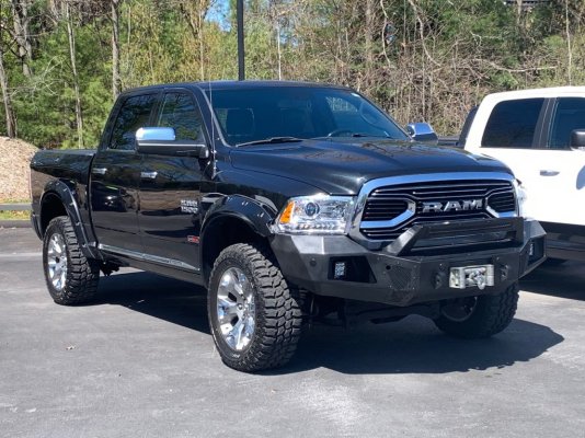

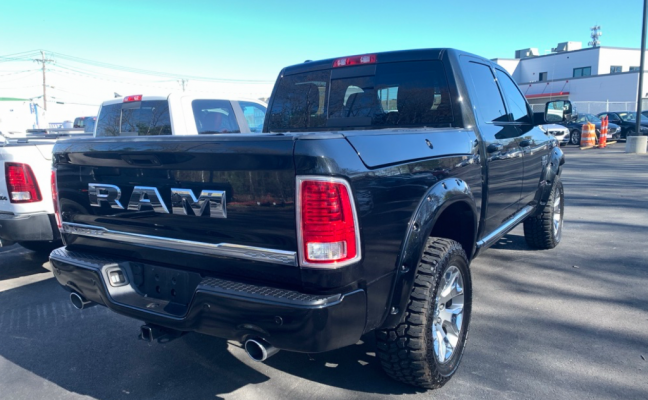

Scenario

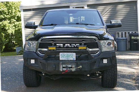

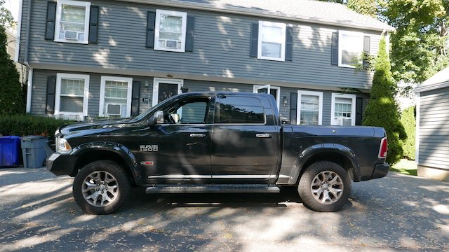

I purchased 2016 Ram 1500, limited laramie ecodiesal last May looking for a rugged 4x4 truck to tow my camper and use for work.
The Ram was built in Canada and imported. The suspension work, front end bumper and winch had been done in Canada
I was told it was lifted 6" by the sales manager at BidCars, Walpole Mass, a used car dealership who—despite seeming knowledge and a good reputation known for selling
lots of pickup trucks in particular—was obviously clueless/misled me into the suspension work and that the ride was normal.
The airbags had been removed and a coil suspension installed.
It's running Nitto Grappler 305 55 20 (diameter is close to stock)
The handling and ride has been absolutely terrible…every bump and uneven road shakes vehicle. It even launched
on a highway bump. I drive mainly highway (Rt 93 here in New England) and travel good highways…the seconday roads are virtually impossible to drive with this truck!)
In frustration I took the truck to an experienced suspension shop in NH where I was told by the owner:
There had never been a lift
Spacers had been put in to raise the front end above the struts!
Here were his suggestions.
1) Spend $2500 to do a proper lift with all the components
2) Take out the spacers, find a used bumper and get rid of the winch and aftermarket bumper (and the weight up forward)
3) Sell the vehicle and be done with the situation altogether. (this would involve I'm sure a loss as the truck cost a fair amount
Ive had three 4x4s in my adult life all with winches and heavy duty ft bumpers.
(A land rover, a Toyota Tundra, a Toyota Landcrusier wagon and a Toyota 4 Runner)
I never ran into such poor riding and handling as with this Ram.
The work done on my Ram was obviously done poorly and I was an idiot to not have it checked before purchase by a legitimate after market suspension shop.
Overall the truck has been a good vehicle. Has 78000 miles. It has every option that works for me. I hate to dump it
From what Ive read on the forum some out there understand these trucks and what's worked.
Thanks to anyone who can offer solutions.

Remove those garbage pucks, add 6112s and set them to 0.8 up front call it a day and keep your bumper to boot
You also need to upgrade the rear 4 link to Clayton off-road
Dont forget Suspension Maxx endlinks as well.
Well there is definitely a lift on it.. the bracket that the lower control arms are on is a giveaway. Makes me question the shop you visited.. I get that they might want to go scorched earth on whatever is on there to guarantee an outcome and that isn't all bad.. but if you are going to spend money it may as well be surgical to get the best result.
If you can, post up more detailed photos of the front and rear suspension.
Folks on here will spend your money for you fast. I'm sure their heart is in the right place but it simply doesn't take $500/ea shocks to achieve a good stable comfortable ride.
Post up photos, see if any of us can spot opportunities to optimize what you have. Ask as many questions as you need to. Any of us including me might be an idiot but if you put together our collective knowledge about the platform and aftermarket with your healthy skepticism and analysis maybe you can get a great riding truck without spending more than you have to.
Scorched earth should remain on the table

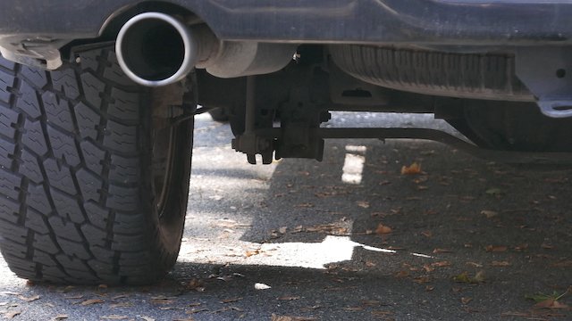

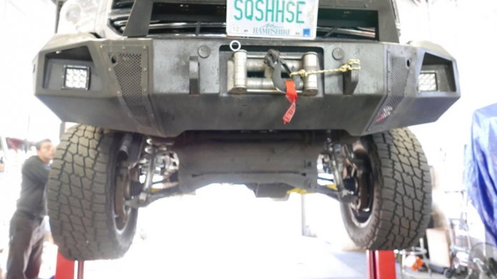

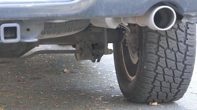

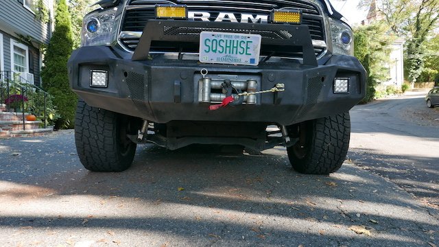

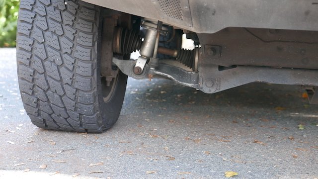

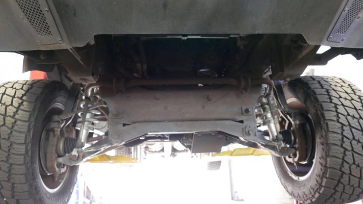

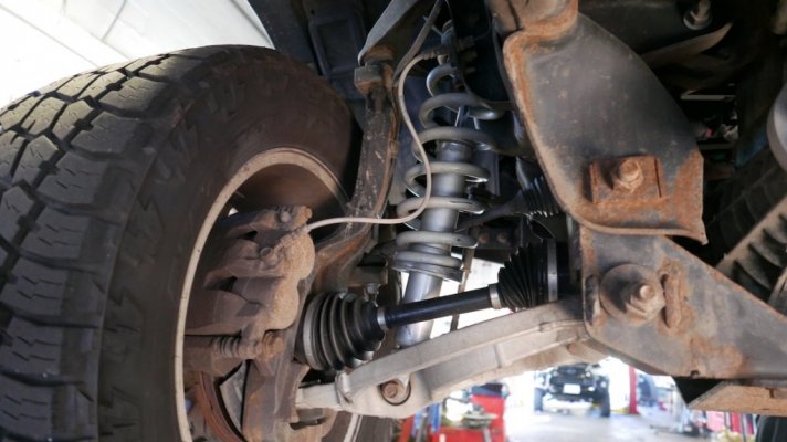

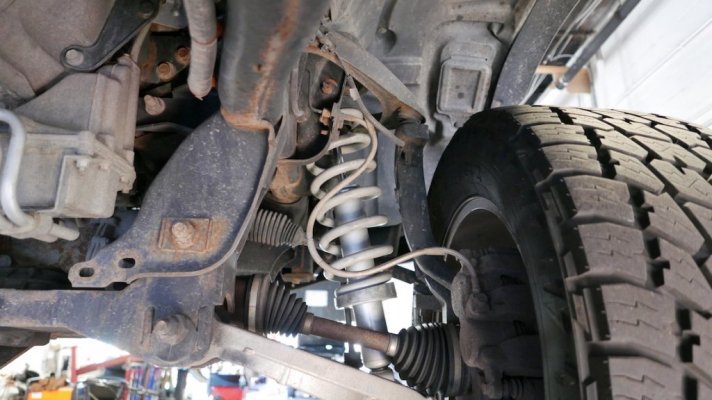

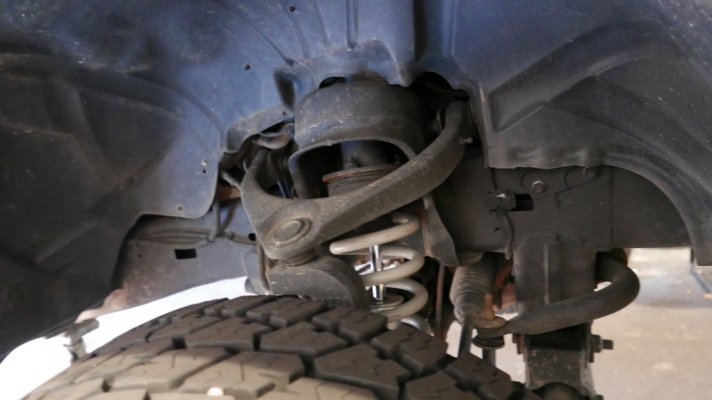

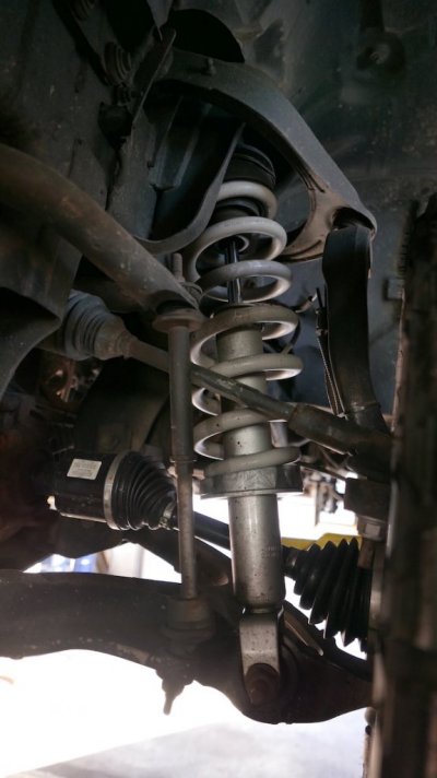

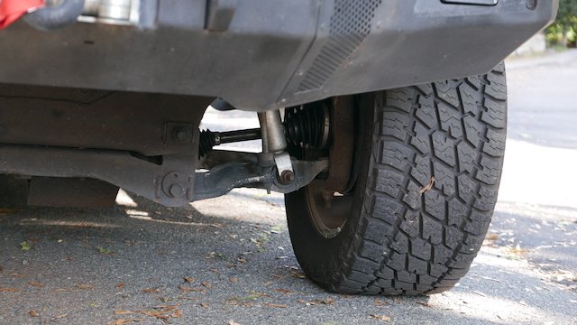

Hi, Back from my mechanic where we put the truck on the lift.
He confirmed that there IS A 4" LIFT. (How the suspension shop in NH stated there is no lift is beyond comprehension)
Rear Shocks are Monroe Reflex
Struts are Masterpro
His Recommendation
---Go back to OEM with airbags
or
---Get rid of lift kit; replace struts and shocks
or
---Keep lift as is, however replace struts up front with quality (Bilstein 6112 kit or?)
and Replace shocks in rear
I told him I would post back to the Ram Forum once you've seen the pictures, where you all would have the most knowledge and been through this. I really don't want to sell the truck, but as Ive said, it's too punishing especially on New England roads to drive the truck. As Kurek suggested, a stable comfortable ride.
I'd like to get this right even if I have to wait. Can be done in stages if necessary?
Thanks much for your expertise.

kurek
Aug 7, 2019
2,662
3,815
Northwest
Edit: newer posts make what I wrote here obsolete.

Thanks Kurek, will run this all by my mechanic for estimate on labor. Have any forum members reading suggestions gone this route? What's been the result on the ride? Thanks again, very helpful toward getting the ride character enjoyable.
BolletuH
Sep 20, 2021
66
36
Wyoming
6.7
Any chance you could take similar pictures of the lift while vehicle is on the ground compressed by its own weight? This would help in determining any potential handling issues regarding suspension or steering axis geometry being off. I don't really want to offer advice until I've seen the entirety of the suspension resting in a position it should be. Also, an alignment sheet would be extremely beneficial to review caster, camber, and toe settings.
Edit: Looks like your driver side CV axle was replaced at some point?

Kurek offers great advice, but don't prematurely jump the gun. Find the problem before just throwing an entire new suspension at it. It took me almost a full year of fiddling with my RAM 2500 before I got the aftermarket suspension on my truck dialed in. Now it floats compared to stock, but it was a lot of trial and error.
His Recommendation
or
or
Initial thoughts, Sway bar endlinks are waaayyyy too tight, The struts are some brand of quick strut with garbage coils and i would put my money on those 2 things destroying your ride quality. I know from experience. PM me know if you want a set of OEM stuts loaded with coils assembled. That way you can start there and decide on upgrading to something like a Fox coil over or a Billstein 6112
GovernorBudNH
GovernorBudNH
Oct 18, 2021
25
New Hampshire
Diesel v6
See photos attached of truck on ground on it's own weight. CV axle was replaced a few months ago by NH Dealer.
