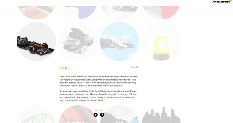

A "rake" in a truck is when the rear is slightly higher than the front already, its normal and comes stock so when the truck is loaded up you dont have a "Bro Lean" which is when the front sits higher than the rear. its popular to level trucks that owners dont often use the bed or for cosmetic reasons to stuff oversized tires for trucks that dont go offroad much but for practical and gas mileage purposes a little rake is beneficial. When I "leveled" mine I left a little rake because I do still use it as a truck.
I know what rake is, in my case the rear sat way too low without the spacer. Not sure what kind of bumper he has but the winch bumper im looking at weighs 300+ lbs and would make a considerable difference in handling without making the necessary changes. I ran a front spacer for years though and my Ram handled great. I know alignment issues could also lead to very poor handling

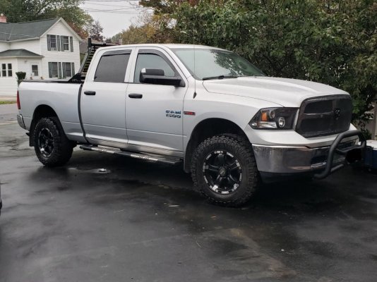

I realize not all these bumpers are created equal but if these bumpers and winches and the additional 50 or even 100lbs alone were a real problem you would see folks all over that would need lifts or stronger struts to compensate yet this is the first ive heard of it on 4 different ram forums. Think about it. many dont think twice to bolt a 25-70lb bull / brush bar and some lights to the front of thier truck... you dont hear of them replacing suspension afterwards. I have seen where it causes the front to drop an inch or so but never seen complaints of stiffer ride quality as a result.
Look at the weight of just this brush bar alone... 69lbs... close to the OPs bumper and winch weight likely over the stock bumper. https://www.amazon.com/Aries-5058-B...ll+Guard+Dodge+Ram+1500&qid=1637849561&sr=8-4
And I do have a brush bar and lights mounted to my crew cab ecodiesel with the 5100s for reference. (old pic as ive added flares and an led light bar) the rear is lifted 2" as well with superlift variable springs which ride fantastic both loaded and unloaded.Inked20211015_080727_2mp.jpg

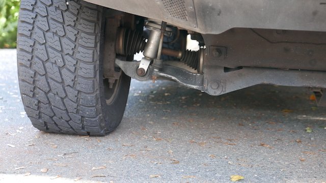

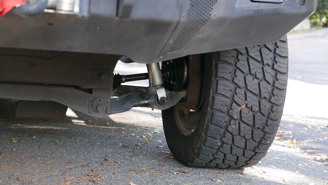

Go back to the beginning of this thread and look at the pictures he posted of the front suspension. This is truly not that difficult to figure out.
Sorry I dont see it... again more weight in the front would make the struts ride softer not harder. All I can determine from the pics it he had big hard 10 ply tires which hes swapped and already stated helped with ride quality. and theres some sort of lift kit mounted on the front end. Ive never had any experience with that lift kit so therefore I do not know if such type of lift kits always make the trucks ride horribly.

I see cv angles that look close to the 3.5" limit and show the vehicle was very likely once lifted much higher. My guess is it had larger wheels and someone dropped it to sell it but did it incorrectly.
Is that what we believe is making the suspension ride so bad? I am not a lift kit expert here. Looking at these pics for the first time though I would say that lift kit should be removed or the vehicle lifted a bit to improve those angles (which will hurt towing mileage )
Just someone who also bought an ecodiesel truck that a PO had modified the suspenion making it ride bad. I chimed in to help with what in fact worked on my truck and to point out that I didnt buy the extra possible 100lbs in the front vs stock would not make the front ride stiffer.
Kurek, I still dont see how your repeated suggestion to mount factory struts and springs would be the solution here? Please explain as I'd really like to know? Im not trying to be a smart@$$ here.

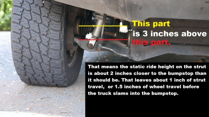

Here is, yet again, the obvious problem and therefore obvious solution to OP's suspension situation.
It is not necessary to be an expert to see when a part that should be pointy-straighty is instead pointy-uppy. It takes only a sliver of curiosity to consider what other parts might be affected by that arrangement.Leftffront.jpg

That NOW explains at last Kurek, that slamming into the bumpstop is the best description for the ride issue...and as you aptly said, "It takes only a sliver of curiosity to consider what other parts might be affected by that arrangement."

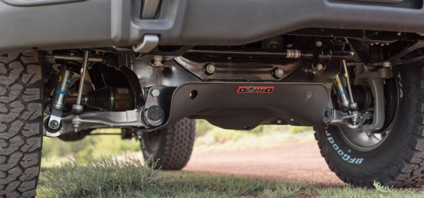

Thank you. How about a photo from anyone on WHAT A PROPERLY ALTERED suspension lift should look like? Sharing this with GR Suspension, the shop in Quebec who did the work for the previous owner. Maybe this is the way things are done in Canada?

I did mention this more than a month ago in this thread and you even responded in agreement.
Here is a photo that shows the correct relationship between the inner and outer suspension/axle components.
It's a different brand of lift but the geometry is approximately the same, particularly the parts relevant to your situation. Notice that the CV axles are just about level, maybe angling very slightly down from the center axle assembly to the wheel hub.
This relationship shows (*) that there is approximately the full, OEM range of upward motion available to the front wheel - it can be pushed up 4 or 5 inches before hitting the bumpstop - which means that will basically never happen on any road situation and only happen off-road when the driver's asking for it.
The solution is coil springs rated specifically for a diesel 1500 or adjustable strut/spring assemblies with a setting explicitly approved for a diesel 1500.
Note that since the vehicle is currently sagging quite a bit in front, correcting the problem will produce the full lift height that the lift kit was designed to produce - in front. That might require a little adjustment in back too.
*(indirectly shows - but since AEV built and installed this we can safely assume)
