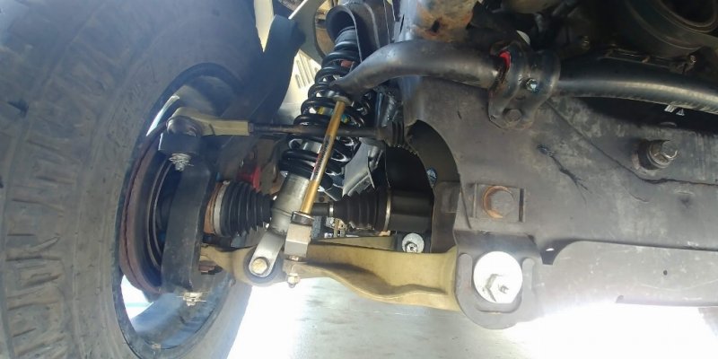

Oh... yeah that's it right there. View attachment 474833
That's a one size fits all strut/coil combo on the heaviest version of the truck and it's probably slamming off the bumpstops every time you hit a crack on the road.
If you posted this photo first it would have saved you a bit of time! :) You'll need ecodiesel coil springs, or aftermarket struts that can be adjusted for the weight of the ecodiesel and the added winch/etc up front.
The good news is now that the problem is apparent so is a solution.
I have to agree. Your CV axle being at a negative angle is rather concerning. I've only ever seen them in a neutral or slightly positive angle when everything is working properly. Maybe the crossmember for dropping the differential was for a taller lift and the coil over spacer was swapped due to some concern from prior owner. I'm guessing you inherited his/her problems. At this point you really do either need to purchase a new full lift kit (assuming you want to keep it lifted), or return to stock height which I know certain bracketry has to be modified to accommodate the differential drop which might not be possible now.
Only other thing I can think of that might involve a bit of time is to find part numbers on all non-OEM suspension components so that you can verify they are of the same kit. If any part in particular was swapped out it could help in you figuring out what to do next if you can get away with finding an mismatched part.

In the ongoing search for a reasonable but properly done fix, this past weekend I brought the RAM to a well regarded shop in northern NH that does much work installing plows and on pick-ups using logging roads. After explaining the ride issues and suspension kaffufles, (not the fault of the RAM but the previous owner BTW) the shop owner took the truck down a combined highway/secondary road with frost heaves. The ride "Shudder" was obvious.
He brought up fact that the 6" lift was by BDS so I sent pictures and called BDS Tech out in Michigan. I was told based on part numbers that the strut is a masterpro strut assembly from O'Reilly. Monroe shocks in the rear. Not great quality.
His suggestion, before spending lots of money on suspension fixes was to swap out the 12 ply Nitto Grabber 303 55 20's with a set of the OEM tires, Goodyear Wrangler SRA 275 60 20s which are 4 ply. The difference in ride should be obvious. He gave me a set of the tires he had taken off another RAM 1500 with 10k miles.
I'm going to do this during the week and re-evaluate the ride. I appreciate the suggestions made by you guys above, and have to do more research as theres no point is spending lots of dollars and not get it right. It is a great truck all around and there has to be some way of sorting this out without selling the truck.
This continues to be your problem and until you fix this with diesel-specific springs OR adjustable struts with diesel-specific adjustment settings you will never fix it.
You can buy used OEM diesel struts (with OEM diesel springs) and install them, or you can mix and match eibach diesel-specific springs onto bilstein, procomp or eibach struts, or you can buy adjustable coilovers or 6112's.
This is because the diesel engine/trans is the heaviest powertrain and those one-size-fits-all mastercraft springs are about as universal as a one size fits all speedo.

I purchased 2016 Ram 1500, limited laramie ecodiesal last May looking for a rugged 4x4 truck to tow my camper and use for work.
The Ram was built in Canada and imported. The suspension work, front end bumper and winch had been done in Canada
I was told it was lifted 6" by the sales manager at BidCars, Walpole Mass, a used car dealership who—despite seeming knowledge and a good reputation known for selling
lots of pickup trucks in particular—was obviously clueless/misled me into the suspension work and that the ride was normal.
The airbags had been removed and a coil suspension installed.
It's running Nitto Grappler 305 55 20 (diameter is close to stock)
The handling and ride has been absolutely terrible…every bump and uneven road shakes vehicle. It even launched
on a highway bump. I drive mainly highway (Rt 93 here in New England) and travel good highways…the seconday roads are virtually impossible to drive with this truck!)
In frustration I took the truck to an experienced suspension shop in NH where I was told by the owner:
There had never been a lift
Spacers had been put in to raise the front end above the struts!
Here were his suggestions.
1) Spend $2500 to do a proper lift with all the components
2) Take out the spacers, find a used bumper and get rid of the winch and aftermarket bumper (and the weight up forward)
3) Sell the vehicle and be done with the situation altogether. (this would involve I'm sure a loss as the truck cost a fair amount

Check caster with relation to overall travel of lift kit design. My thought is there is an issue with this. Ball joint trouble? Can be a problem. Upper control arm....

4ply tires will make the ride alot better than the 12 ply's However that is honestly too low to run on a 1/2 ton truck that tows. You should be running a 6ply at minimum - load range C. I would honestly run a D or E depending on your camper weight.
As far as the suspension goes, if you swapped to the correct spring rate struts you would have the factory ride or better back. What you got going now is essentially a fat man riding a childs pogo stick. Contact Nick@gotexhaust on here and he can get you squared away with the best deal on a pair. Your lower control arms should never be going up when under normal driving conditions. They should be flat or going down.
These trucks handle lifts really well when everything is right. In fact many people report them riding better than stock at 4-6" of lift.
