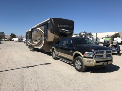

I have the exact same truck you do with factory rear air. I just pulled my 5th down to a site last weekend and it was super stable. I was way over my payload limit and the rear air leveled like a champ. When I set alternate trailer height and tried to go back to normal it gave me the limited use warning due to payload but I turned the truck off and back on and it cleared and leveled.
I was at 4920 front, 6800 rear and 13300 trailer for a total of 25020 GCWR. The only thing I was concerned about is my rear GAWR is 6500 so I was 300lbs over that. But was under my tire rating of 7200. If I had shifted some weight to the rear of the coach I would have been good.
With the trailer brake gain at 6.5 and exhaust brake on full it stopped like I didn't have a load at all and I was running the 580/680 through the pass outside Livermore. Most of the time I didn't even have to touch the brake.
You will have zero problems with your setup except from the weight police on the forums. Weigh stations are for commercial trucks as stated above. I had numerous CHP and county cops passing me (55 mph limit for trucks pulling trailers in CA) and none even looked my way.
