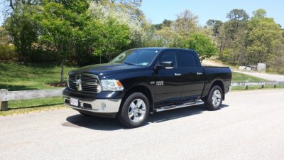

I got just under 2" of lift after alignment and settling. Left me with about 1" of rake which is exactly what I wanted.

Mine looked nose high before alignment but settled to about 1" of rake after
