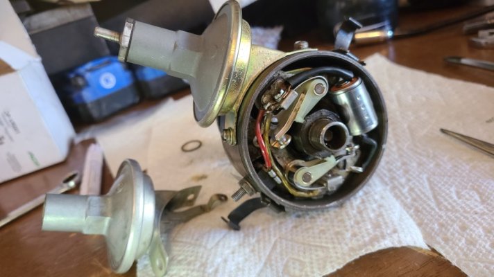

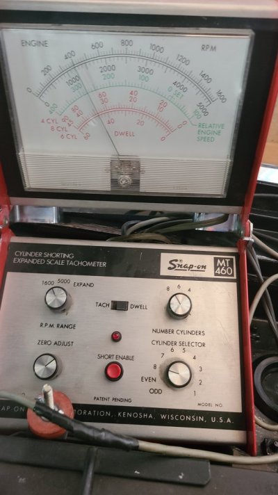

I always found the matchbook cover was too thick for my mopars. 0.019 initial for each side of this dual point that I had out today to replace the vacuum advance. Always eyeballed it if installing the points in the car. Then adjust with the meter.
31 on each side and 34 combined dwell. Should be closer to 36. Doesn't run as well if I widen each side out to 32, so this is how I've set it up for years...

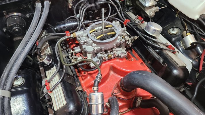

Or no choke. This carter hasn't had the butterflies for the choke on it since before 75. Even in subzero, pump it three times, set the fast idle and start and let it get warm

WELL dem RocketChesters, lmao, always had the heat coil/riser to set choke. I got so tired of it, I just removed the rod and put on manual wire, solved all the BS starting issues on carb.

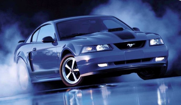

The only non-truck I would ever buy in the rest of my lifetime. The 2003 Mustang Mach 1 in Azure Blue. Nothing special power or performance-wise, but this thing has lived inside my brain like a tick for the last 22 years, much like the Porsche 959 poster I had hanging on my bedroom wall as a teenager.

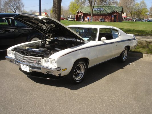

^^^ I would love a 1970 Apollo White Buick GSX Stage 1.
You just don't see them around anymore. I can't remember the last time I saw a GSX at any of the car shows.
There's usually 1 or 2 that show up at 3 Hills and i think i seen 1 at Airdries Doing it on the Grass show last August Shawn
