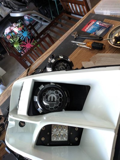

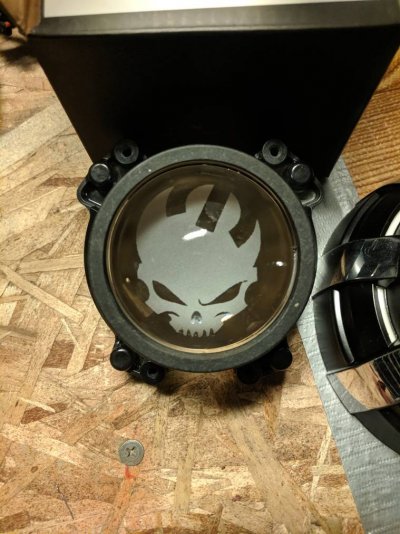

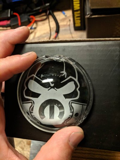

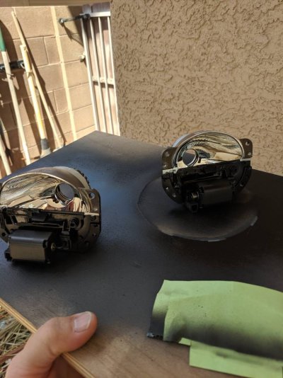

So I have my very first pair of headlights I opened and after learning a lot over the last 4 sets I've finally decided to reopen them. Theonky thing I did to them the first time was add a flush mount led pod in place of the high beam. This time I plan to add a D2S Morimoto 3" projector with black passive demon eyes and rgbw demon eyes with a halo on the shroud. Also adding an etch to the lens. I've only had them open for three days and already got a lot done. 05c0075d43d1d74afc4324b8e7b55ef9.jpgc55c6b03b859fb03d0d2917a7cbcd405.jpgcf8f87a80449d606e4524329f18ff223.jpg

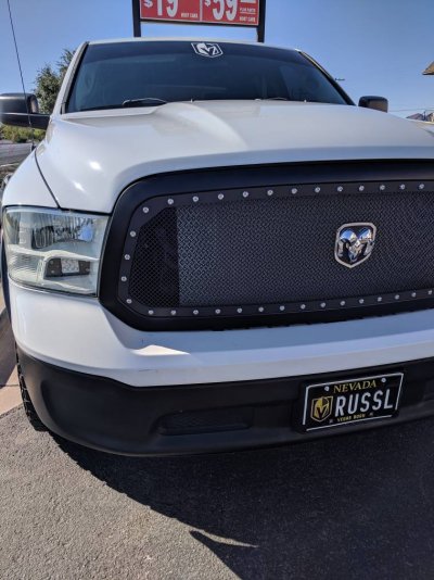

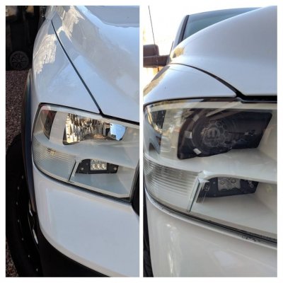

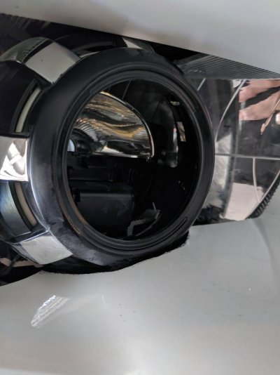

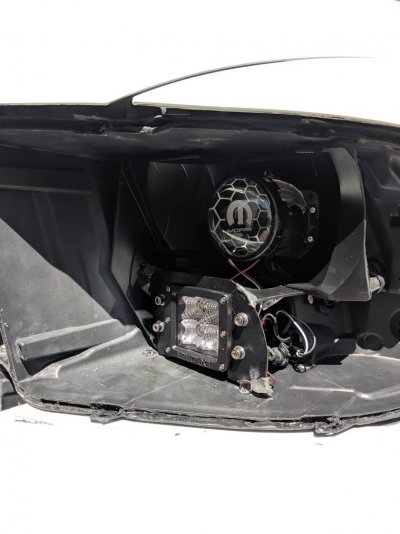

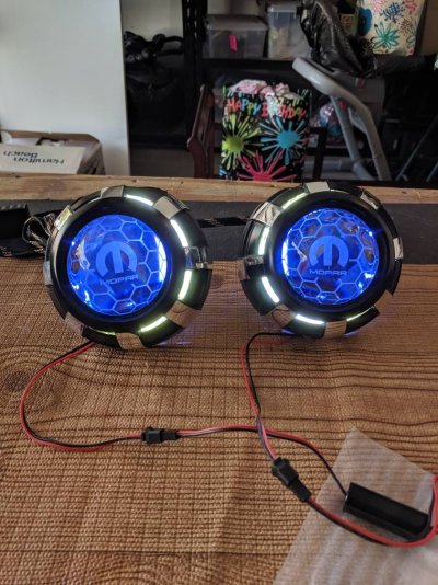

Got all the wiring done a put together. Still need some night and output shots.a592115eee6774bc74449f8dac438e84.jpg58f2dec344e3c36e3c7a0a317a062060.jpg822f2e6d7ec227749fe37e47b85e2728.jpgb73fb68e0249ba27f72c659c3694039a.jpg1b3923824defbbc043a1bb496cf8f156.jpg

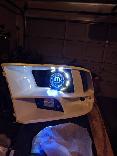

Lows, highs, demon eyes1ad021d1c319cd63dcef4a54720a8eb0.jpg9be1a700d020b756e18dc11dc6b3a59a.jpg7d52c74ed9ec4830cd87d2de5a831116.jpg

this is pretty sweet i am wanting to do something different with my headlights and am having trouble making a choice. I like the way this looks alot. How difficult was it to put the projectors in? and how does the demon eye work do you have a separate switch for it? can you change the color? also minus the led pods what do you have in money wise if you dont mind me asking. If i peiced it together correctly im looking at about 200 smacks minus ofcourse time and effort

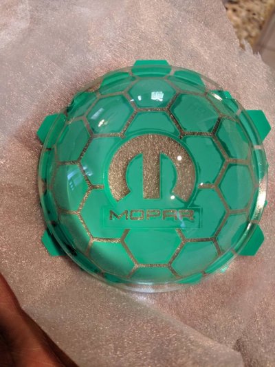

Sky is the limit with these lights. I was able to find the projectors on FB market for $80 with halos. I think I spent around $100 for RGBW demon eyes and controller. I etched the lenses myself. I use the power from the parking lights. So when I turn just parking lights on, the demon eyes come on. If ur handy with a Dremel then it's not to bad. The size of the projector is what will decide the amount of work. 2.5" projector with a slim shroud will be less trimming the a 3" projector with a big shroud. f75736d5ac1e321916c2a0d419bfc3f7.jpgba31556e285eae247aa46a1d8e1e839f.jpg
