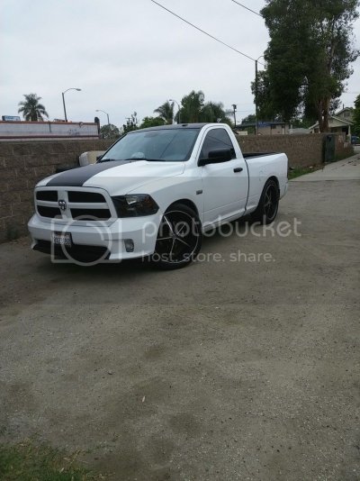

Has anyone done rear airbags on a single cab 2015? i got a set of bags bu cant fint the brackets for them, i pretty much want it low but i did a drop and its too bouncy

Thats what i was thinking and i searched alot of site but so far no support for the 4th gens, I even had to order universal bags for it

i ended up welding rear airbag brackets and just ran a T-line with the nipple sticking out the gas, rides way better and kept the look i wanted

I used Ride-Rite universal bags and got a metal guy to fab me up some brackets and just tan a T line into them. Ill take pictures once i get it back from the interior guy.
