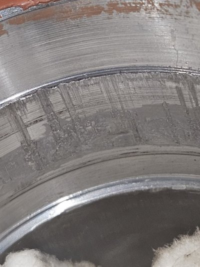

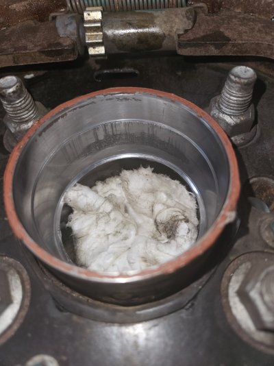

Continuing my brake noise saga, I pulled my drivers rear axle seal and bearing, and here I am so far:
After pulling, I noticed some roughness in the bearing bore:
Bottom:
Top:

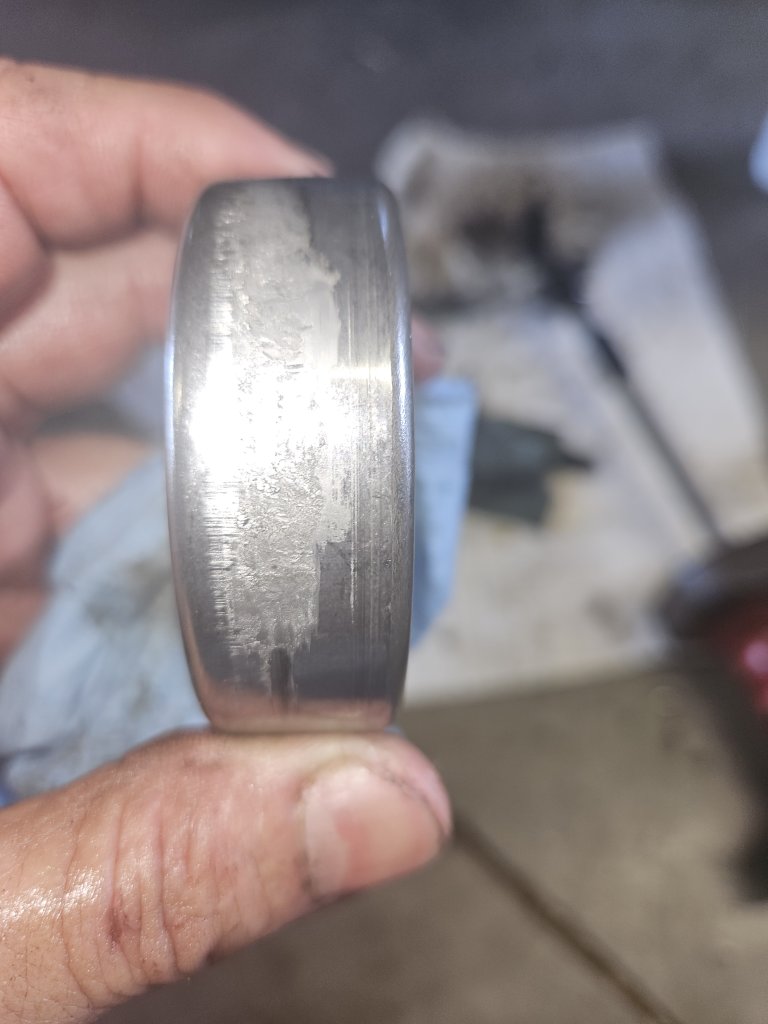

I cannot afford a new rear end, hope I can clean it up with some fine emery cloth. Top of OE bearing:
I don't have much choice at the present except to clean it up and install new bearings and seals, and hope for the best.
Thoughts?

I hit the top with some 2000 paper, looks much better, I can only do what I can do.
Makes me wonder if that bearing was getting hot under load.
It did not want to come out that easy, either.

I could not see any issues with the rear bearings, except that scarring on the OD and the corresponding bore scratching. So, I'm glad I have 2 new OE bearings installed. Got both from RockAuto for the price of 1 from my local dealer.

Yea, for the bearings, it doesn't matter so much what the surface finish in the bore is like. As long as the outer race presses in firmly and remains centered and square to the axle's axis of rotation. The surface finish that really matters are the polished faces that the bearing roller elements ride on.
I've installed new bearings in old lathes and milling machines with bores that looked like hammered ass. As long as the bearings are quality, they always cut good and accurate.
Kinda what I figured. Funny thing: I originally bought 2 bearings and seals from O'Reilly, was about $68. Made in China, not surprised.
When I opened the boxes, one bearing was in a sealed bag, and one was not. When I looked closer, the bearing that was loose was marked USA, an OE bearing, but a couple rollers had rust. No bueno. Got a refund, and ordered the OE bearings and a couple National Seal brand seals from RockAuto.
I had one hell of a time pulling that driver side bearing out of the tube, I had to install a heavier slide on my puller to persuade it.

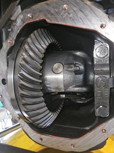

I figured that it is surrounded by oil, and my bore wasn't super-damaged, so I should be ok. I am glad that they are changed, one less thing to worry about, and the inside of my diff looked good to me for having almost 193,000 miles.

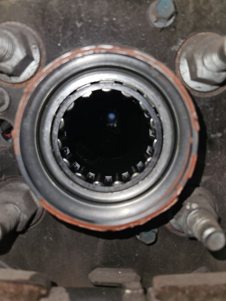

The O.D. of the axle housing on a 1500 is unimportant. The issue with 1500 rear axles is that the bearing rollers run Directly upon the axle-shaft with no race to protect the shaft and rollers from each other. (BTDT and replaced the OEM’s with Yukon axle shafts… no more problem….but the 1500 Ram rear axles simply are light-duty. I’ve moved on to a 2500.)
