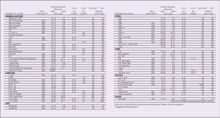

Hi, I’m replacing one rear axle shaft seal on my 2016 Power Wagon. Not the pinion seal. The question I have is about setting proper wheel bearing preload. Chilton says torque to 22 ft/lb while rotating the hub in and then back off 1/4 turn. Next hand tighten to remove any felt play. Others say tighten it to the same torque and back off 30 degrees and then go to where the nearest notches align for the key. I have also seen that it should have between 1 and 5 thousandths play. I have a dial indicator and everything else required. So what is the best method?

Yukon gears has a great little chart

The chart above is for pinion bearings which is completely different than what is being asked.
