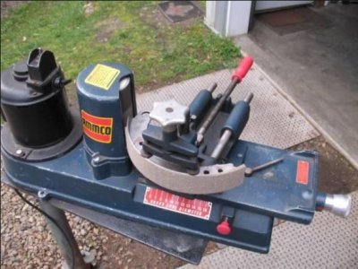

Usual Suspect
Nov 25, 2017
13
17
Pentastar 3.6
Used to be pretty common to take a skim cut on new shoes on the grinder to get them to fit with new drums and to true them up.
