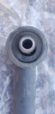

20201206_132801.jpg 2nd time to replace since I iboughttruck new Dec 2011.
anyone replace cheap rubber with press in urethane bushings ?

Don't know if somebody makes poly bushing for the stockers. But you can find stock replacements for like $40. Plus you wouldnt want rigid poly bushings if the truck was 4x4 and you will be putting her in 3 wheels. The stress on the mounts would be crazy with poly bushings. That works on muscle cars because you want both tires planted to the pavement so if you lift a wheel is because you're switching the tire :)

I replaced all 4 on my 2010 with Dorman OE arms for $140 total.

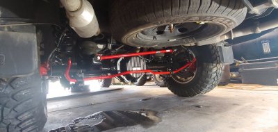

Cant believe how much better these trucks handle with new control arms, track bar and a sway bar from Hellwig.

Oh yeah, couple of mods in your suspension and she will handle like a dream on wheels :), starting with Kings 2.5 race shocks, Clayton Overland+ rear arms, soon Clayton panhard, Hellwig sway bar with Core sway bar links

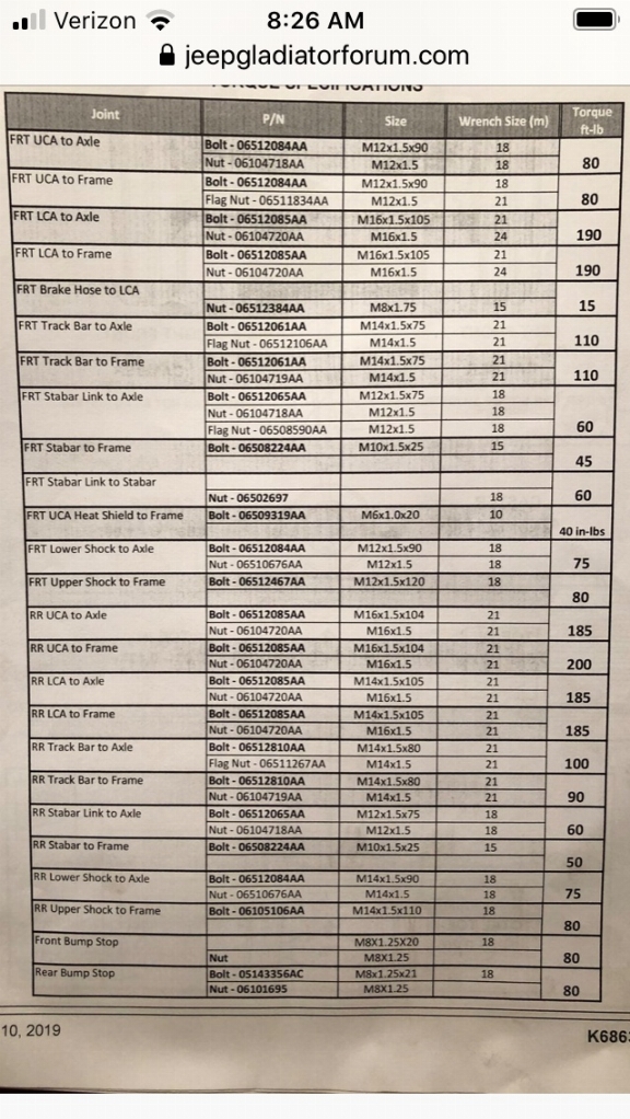

Clayton made their rear control arms bushings to wishtand the factory Tq specs on their rear control arms, which we share from our 4th gen 1500 trucks since FCA borrowed them and fitted in the Jeep. I adjusted all of them on my Claytons to 195 ft/lbs.
These are factory specs on the Jeep 20/21 Gladiator, in this case we're only looking the rear control arms to confirm specs. Factory RAM is 190 or 200, so i splitted the difference and went 195
RR UCA to Axle
RR UCA to frame
RR LCA to Axel
RR LCA to frame
