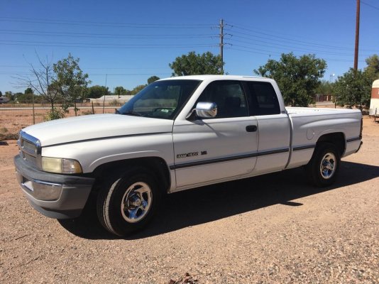

I had a bad rear end whine. Some said tire noise, some brakes, some rear bearings...
I found a Chrysler master tech that drove the truck two blocks and said “rear bearing” as in pinion bearing.
My truck had 316k miles so he went ahead and replaced the whole rear axle. Truck has been running and sounding great!
