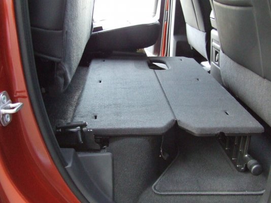

Does anyone know what years and trim level had the rear cab folding shelf when the rear seat is folded up ?
I am looking for one for my 2003...not sure where to look.
What did Dodge call it ?
Thanks

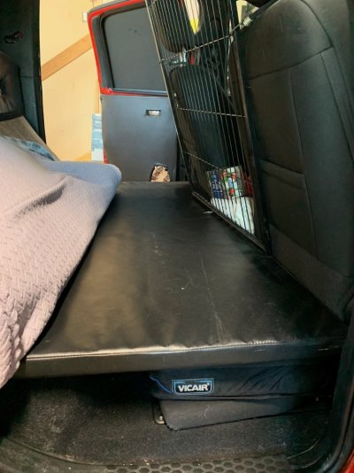

I took out the back of the seat and the seat itself. Replaced with a 1/2 plywood board 64x32 for the back and 64x 40 on the floor. First did tons of sound deadener on the metal in both locations.Covered the plywood with 1/2 foam and more sound absorbstion, then automotive vinyl, sealed off the rear vents. Then removed floor air vents and rear speakers and the full door trim. Replaced door trim with automotive hardboard and more sound deadener with the vinyl covering. Quiet as a mouse back there for my show dogs..big enuf for my huge transport K9 crates.

Thanks, Dave that sounds great. Care to share a few pics? :cool:

IMG_0311.jpgDid not finish the top by the 30% tint yet but it is attched with original seat bolts as seen in other pics...removed a/s floor vents as not needed with the dogs
