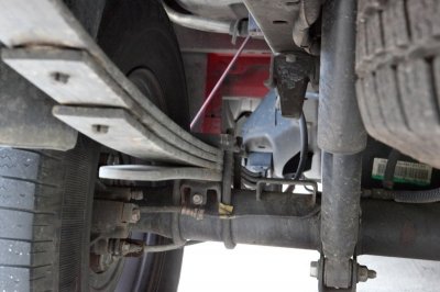

I suspect the leaf spring has probably lost some of its Arch and is causing the height difference.
Here is a picture of a sagging leaf spring. Does your look like this?
