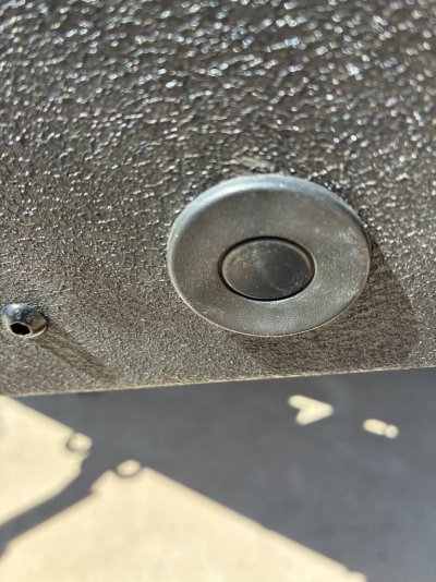

I was messing with them but they are pretty flush.

Number 3 and 5 are going to cause false readings due to the angle they are on. One may also be a problem.

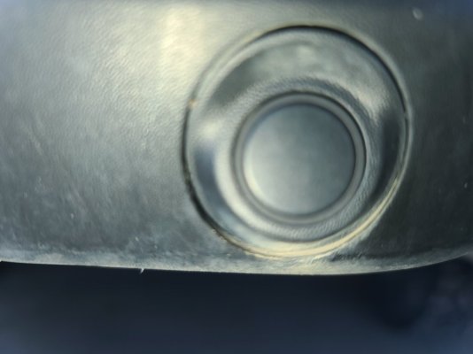

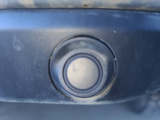

This is what they should look like. There are only 4 on my 2021 2500 rear bumper too.
Right side near license plate
Far right
