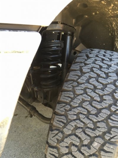

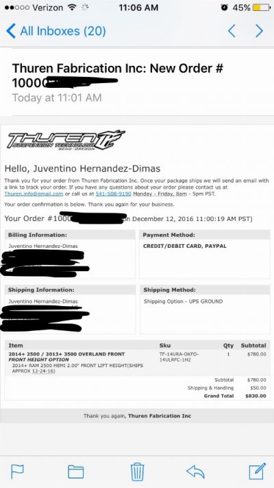

I just ordered 2" Hemi coils, Overland front shocks and adjustable track bar from Thuren. I wanted to upgrade my front and rear shocks, eliminate the shock extensions, as well as upgrade my coil spacer, and was going to get Overlands all the way around. Thuren advised me to not use their shocks with OEM rear coils. Their shocks are for their soft rate rear coils. So, what would make a good replacement for the OEM HD shocks in the rear as well as be a good combo with Thuren Overlands and coils in the front
