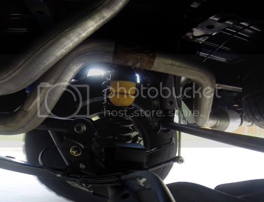

I still have a knocking noise comming someone in the rear end so today I put a gopro on the rear diff to see if it would give me any indications. Still cant find the noise however I did notice this. The Drivers side spring seems to be bent forward where as the pass is near vertical. Also it is not an illusion due to the camera location it is truly arc'd. The truck should be balanced minus 1/2 tank of fuel and it is sitting on level ground. Any idea what might cause this and what a fix would be?
Thanks again
passenger side
drivers side

Honestly they both look somewhat bent... But the drivers is worse looking*.
The problem with these new Rams is the spring buckets are all at funky angles for some reason. Go look at the fronts springs on a 2500. They're all kinds of bent, and mine look even worse after the RCX 2.5" level.
Plus, look at the upper mount, it's pointing to the rear of the truck, but the axle is difectly under it. So it puts that bend in the spring. The only way to fix some of that would be to put aftermarket arms on the truck and adjust the pinion angle down. But then you open up a whole new set of problems.
