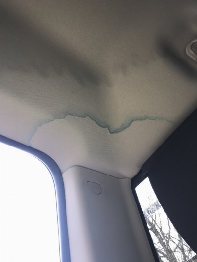

So awhile back I noticed that around my rear window there were stains for where water had leaked through. Well it has gotten way worse I noticed it had gotten worse when the car wash soap started to leak through. Any ideas where it maybe coming frome2583afa89f56b707eb24d2dbb99c2ab.jpgb4e0cc1ef878563d6f8599709fefa1f4.jpg

3rd brake light, outside rear of cab. The gasket leaks. Known issue.

The 2 most common spots are the 3rd brake light or the shark fin antenna.... I would think the antenna by the location of the leak stains.

3rd brake light seal might be bad, slap some silicone on it.
In my case, the leak came from a ****** rear-window replacement job that resulted in water getting stuck behind the silicone mounting the glass to the cab. Got that replaced and no leaks since. Hopefully yours is just the 3rd brake light.
Also you can remove those stains with a steam cleaner like you’d use on the carpet.

The foam seal around the 3rd brake light disintegrates and is a very common spot to let water in- there are a few threads on here to replace with a compressible gasket- easy 15 min DIY, however I don't have any experience with the antenna leaking

I agree with the third light leaking. Wow that must be leaking bad. Water always seems to find a its way.

Mine did the same and it's a common issue. I sealed the 3rd brake light but also put you some black rtv or whatever where the roof drains/runners meet the back window. Just peal the trim back slightly and load that spot up.
For the roof stains, get a good auto upholstery cleaner and just work it slowly. I used a microfiber cloth and had to go over each spot 3-4 times. Once it dried it's like they were never there.

Apc, and a microfiber will remove that..maybe a little bit of steam [emoji1360]

Mine turned out to be the runners, not the brake light. I suggest sealing both. Pull the black rubber strip up at the rear of the cab just slightly. Seal it up where the sheet metal is welded. I used a clear silicone for outdoor use and haven’t had a problem since. That was 3-1-2 years ago.

Thanks for the replies guys! It’s on both sides the one with the blue stain is the passenger side the other is the driver side. I’m going to do both things suggested and seal the 3rd brake light and the rain channels. Thanks again
